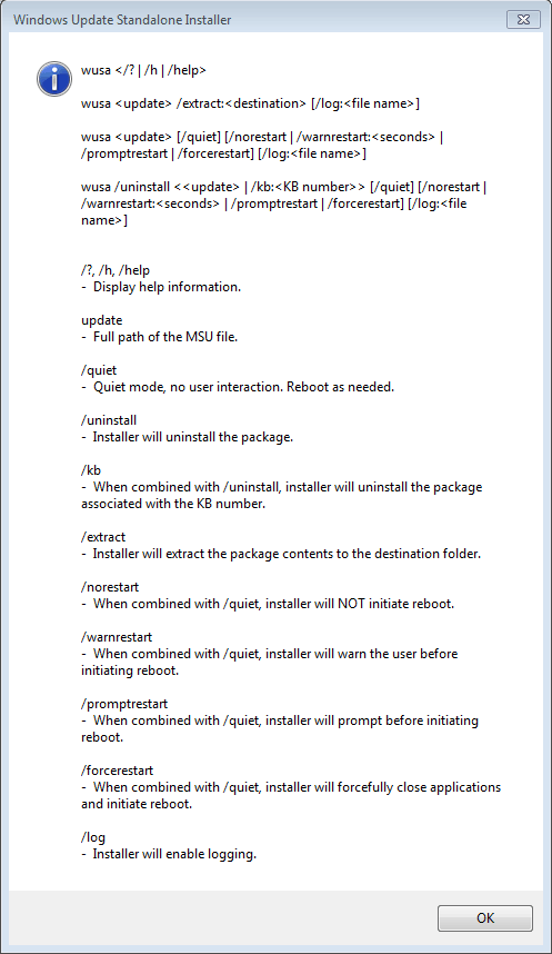

Full syntax of wusa.exe when called without parameters:
