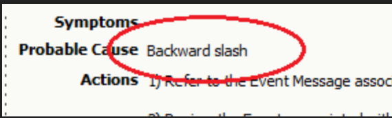

Probable Cause files with backslash "\" characters do not show the backslash characters in OneClick Alarm Details tab. The backslash was added to the Probable Cause file using the Event Configuration tool and saved.

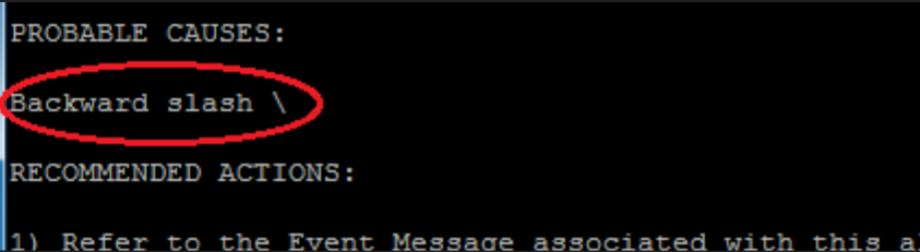

The Probable Cause file saved in the $SPECROOT/custom/Events/CsPCause directory contains the backslash.
However, if you exit the Event Configuration tool, start it again and select the same event, you will notice the backslash is now gone. However it still appears in the Probable Cause file saved in the $SPECROOT/custom/Events/CsPCause directory.
Additionally, Alarm Details does not display the backslash:
