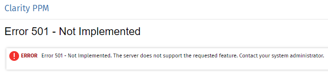

  • Error 501 - Not Implemented. The server does not support the requested feature. Contact your system administrator.' Error while accessing the 'General' Page of Clarity.

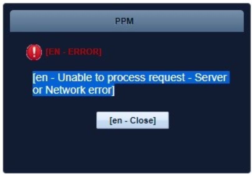

  • [EN - ERROR][en - Unable to process request - Server or Network error] [en - Close] (This one may be noticed when using Single Sign On (SSO)

Screenshots below of a couple of errors you may see:
This may only impact one or some users, where most of your users are able to sign into Clarity and use the application. You may be able to see your normal landing page for a few seconds (typically the General page) but then the pop-up is shown with the above error message.
