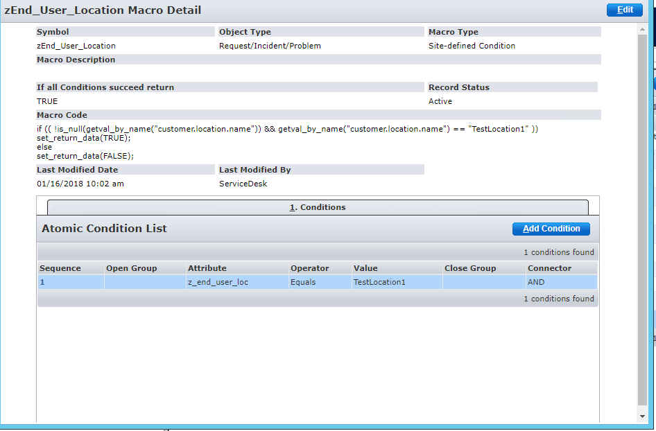

Create a new Site-defined condition macro as follows:
