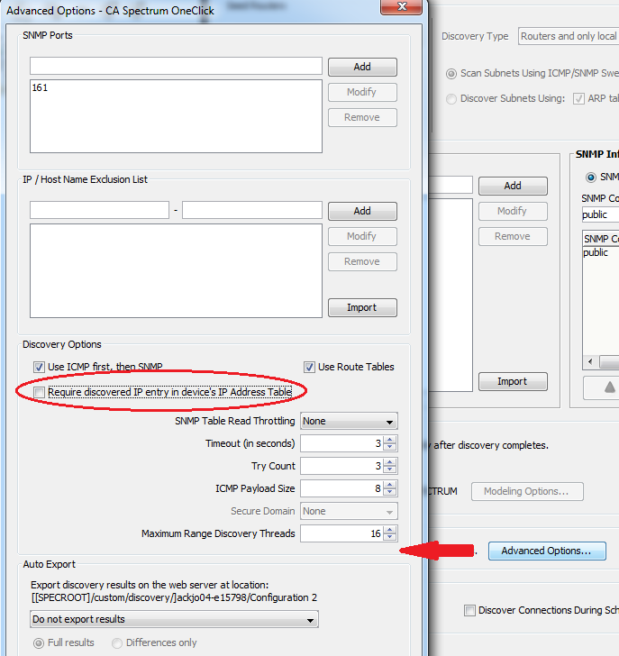

NOTE: You can tell the AutoDiscovery process to ignore this message by clicking on the "Advanced Options..." button in the Configuration tab and unchecking the "Required discovery IP Entry in the device;s IP Address Table" check box.
