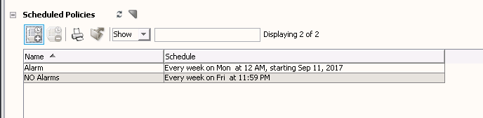

Create a new SANM Policy with just one Filter. In this Filter, Exclude ALL landscapes in the Spectrum environment so there are no landscapes in the Include column.
Then use the Schedule Policies function to schedule the policies. In this case, the NO Alarms Policy is scheduled to take affect on Friday nights at 11:59 PM. Then, the Alarm Policy is scheduled to take affect on Monday nights at 12:00 AM.
