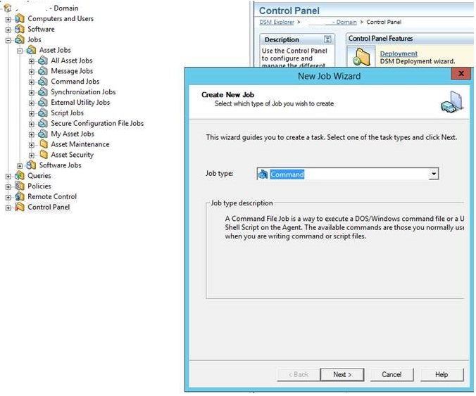

Example for AM Job :
  • Create a new Asset Jobs of type “Command”:
  • Give a name to the job. Ex: Remove amagent postregistrationplugin
  • In command textbox put this line:
ccnfcmda -cmd SetParameterValue -ps itrm/agent/solutions/uam -pn postregistrationplugin -v ""
  • In Scheduling options, put “Run only once”:
                And make sure that “This job is allowed to run unattended” is checked under Miscellaneous tab
  • Then assign this job to all machines
