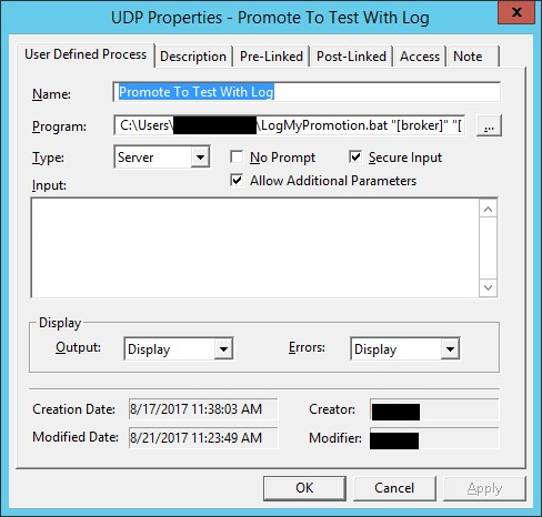

Next, you will open Administrator Tool, navigate to the project and state for which you want this logging to occur, and create a new “UDP” process.  You will use the Harvest “System” variables to pass into the process the name of your broker, project, state and package, whatever information you need, up to the point of entering the comment.  Make sure the “Allow Additional Input” field is checked.
(Program field = C:\Users\<userid>\LogMyPromotion.bat "[broker]" "[project]" "[state]" ["package"])
Notice that the comment parameter is not included on the command line in the Program field.  This is because the comment will be supplied in the “Additional Input” field at runtime.

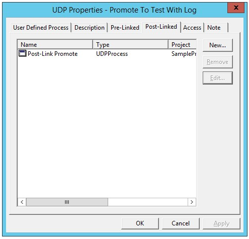

You will also create a post-linked process for your new UDP process that executes the hpp (Promote Package) command line utility.  Here, as well, you can use the Harvest “System” variables to provide the needed information to execute the process.
(Program field = hpp ["package"] -b "[broker]" -en "[project]" -st "[state]" -usr [user] -pw [password])
To use this new UDP process, in Workbench the user will right click on a package and select the UDP you created to promote the package.  A dialog will pop up providing the “Additional Input” field that your user can use to enter his comments for the log file.  Once he clicks OK the script executes, followed by the “hpp” command.
