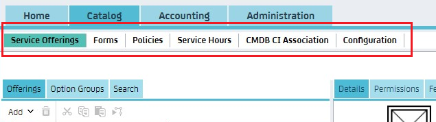

After upgrading CA Service Catalog from release 12.9  or 14.1 to 17.1 or from 17.1/17.2 to  17.3  it is possible to find that menu options are missing under the Catalog tab.
Same can also happen if the EEM implementation is replaced

E: Then restart the Catalog service.
After this, the menu items should be visible again.
