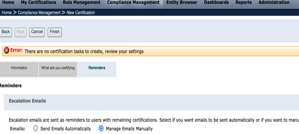

Campaign fails with Error: There are no certification tasks to create, review your settings

When launching a campaign, it fails with "Error: There are no certification tasks to create, review your settings."
The message does not necessarily indicate a problem. There may be no certifications required for the campaign.
