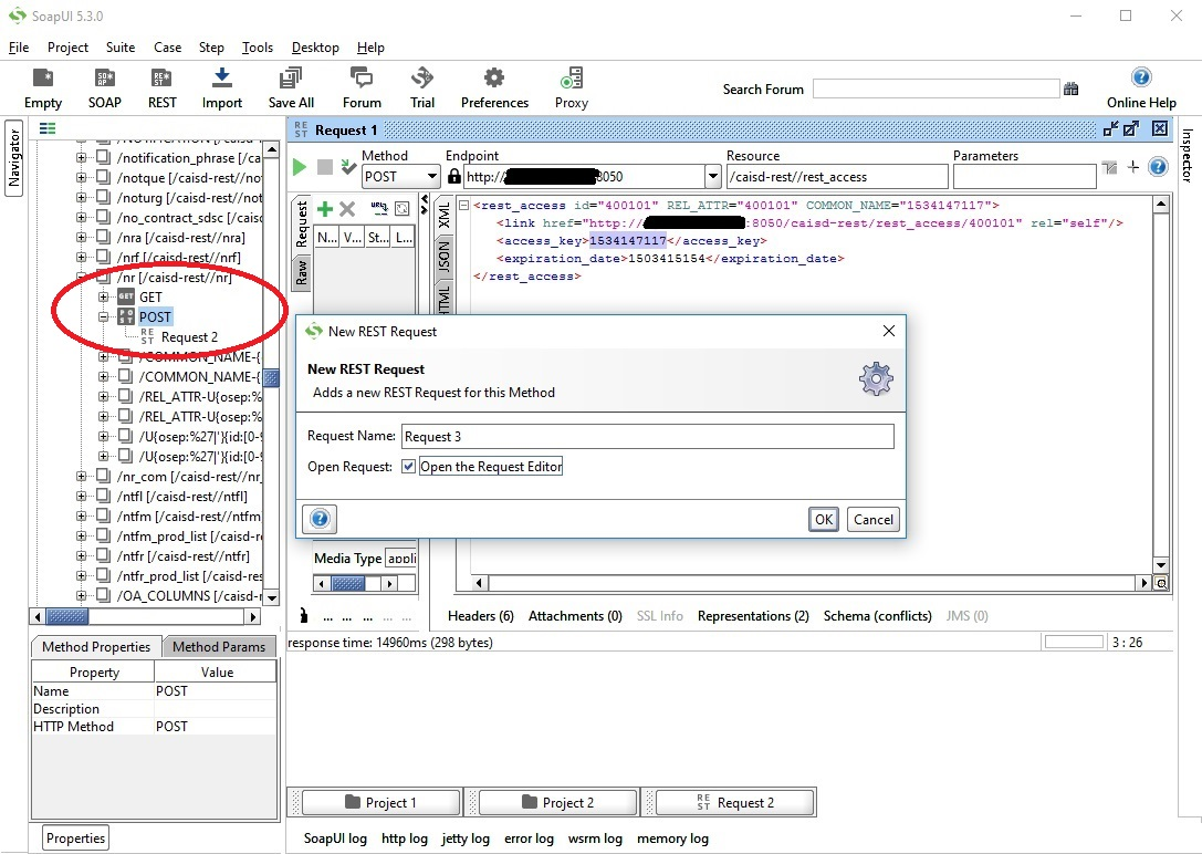

  3. To do this, scroll on the left pane until you locate the "nr" resource.  "nr" is the Network Resource object, or Configuration Item.
  4. You will then need to create and configure a new POST Request.  On the POST entry under "/nr" right click and choose "New Request"

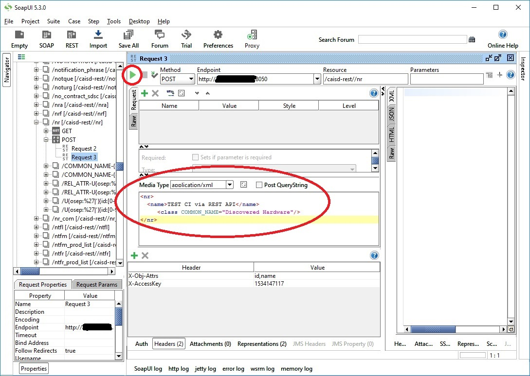

  5. To configure the Request, on the lower left of the Request pane, access "Headers" and add the following entries:
    Header:  X-Obj-Attrs
    Value:  id,name
    Header:  X-AccessKey
    Value:  The Access Key integer string you had acquired when you initiated the connection through the rest_access REST call.  In this case, it was 1534147117.
  6.  Just above the Header display, you will see the Media Type settings.  Change the drop down to read as "application/xml" and enter the following string sequence in the text below:
    <nr>
    <name>TEST CI via REST API</name>
       <class COMMON_NAME="Discovered Hardware"/>
    </nr>
    The above content names the parameters that will be used to create the given CI.  This is a simple and basic CI that assumes all out of box functionality, no additional customisations to introduce required fields.
  7. Once the above has been entered, on the upper left of the Request display window is a green triangle "play" button.  Click on the button.

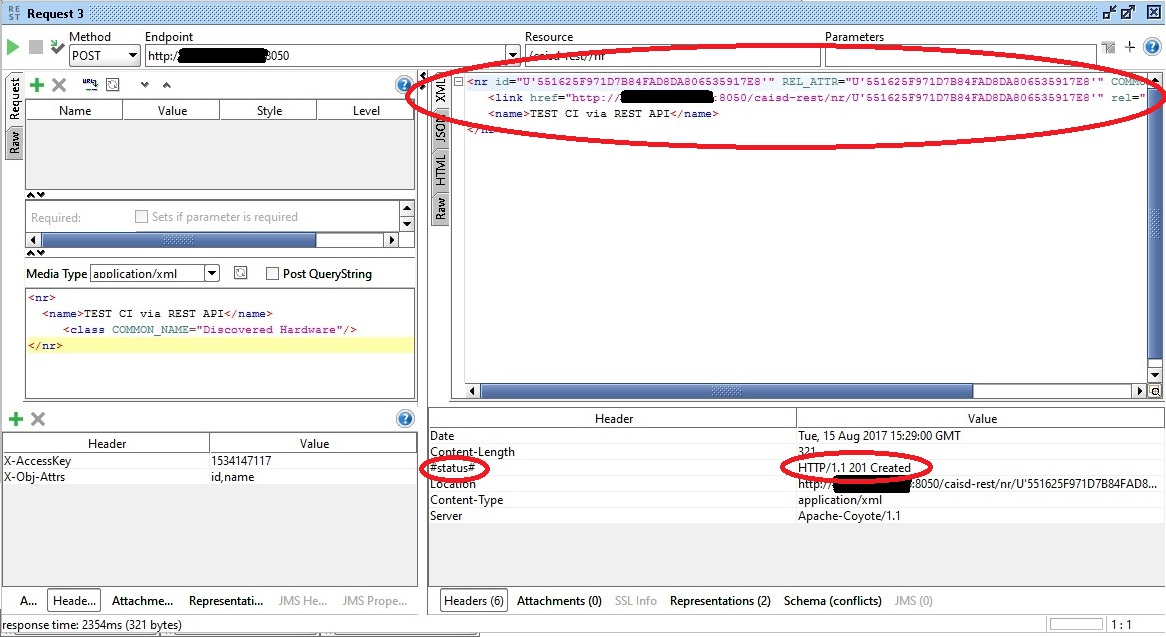

  8. A new CI is generated.  Output generated on the right hand XML tab should read something like:
    <nr id="U'551625F971D7B84FAD8DA806535917E8'" REL_ATTR="U'551625F971D7B84FAD8DA806535917E8'" COMMON_NAME="TEST CI via REST API">
     <link href="http://SERVER1:8050/caisd-rest/nr/U'551625F971D7B84FAD8DA806535917E8'" rel="self"/>
    </nr>
  9. Notice under "Headers" tab on the right hand side of the Request display that the "#status#" shows "HTTP/1.1 201 Created"
