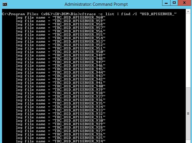

This command line returns all APISERVER log settings stored in comstore
cftrace -c list | find /I "USD_APISERVER_"

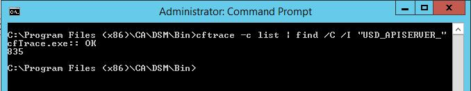

Following command returns the number of APISERVER found in comstore :
cftrace -c list | find /C /I "USD_APISERVER_"
835 found in this example :

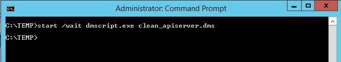

1- On Domain or Enterprise Manager, copy the attached file clean_apiserver.dms in a temp directory (eg: c:\temp)
2- Open a Command Prompt with Administrator rights and execute this :
cd /D c:\temp
start /wait dmscript.exe clean_apiserver.dms
This command could take 2 or 3 minutes
It generates a log clean_apiserver.log under DSM\logs

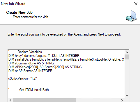

This script could also be executed via an Asset Job linked to Domain Manager with a scheduling to run only once a Month.
1- Create an Asset Job of type Script :
2- Give it a name (ex: Clean API Server)
3- Copy/Paste the content of file clean_apiserver.dms :

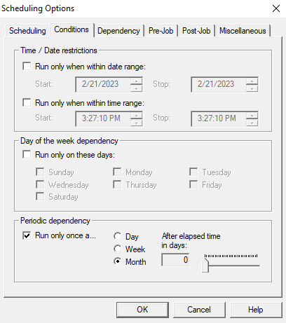

4- In Scheduling options put "Run only once a Month"
In Miscellaneous tab, check "This job is allowed to run unattended" :
