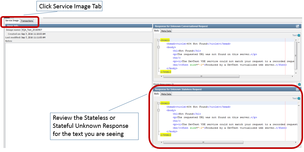

Validating VSI in the Workstation:
1. Service Image Tab: Open the VSI and CLICK on the Service Image tab in the upper left.  Review the response in the Body tabs on the right (unknown conversational /Stateless response). The NO MATCH response is coming from here because the VSI could not match any transactions to an incoming request (located under the Transaction tab next to the Service Image tab). When there is no transaction match with the Request, DevTest sends the default no match Response "The LISA VSE service could not match your request to a recorded request".
