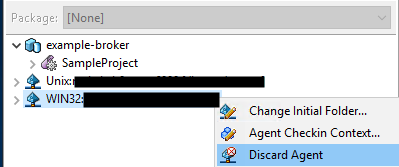

After my upgrade, I opened Workbench and can see several existing Agent icons.  Can the displaying of agents be turned off in the Explorer window? Why are the agents being displayed? How do I removed them?
Harvest Software Change Manager v12.x and higher
Those Agent icons represent agent connections that had previously been made with Workbench on that computer. To remove the connection, right click on it and select "Discard Agent Connection".
