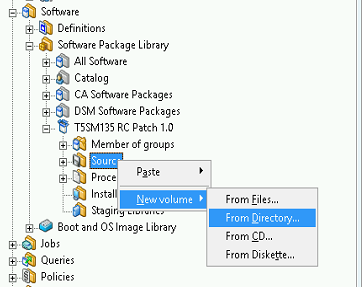

4.    Right-click and select 'Source' -> 'New Volume' -> 'From Directory'.

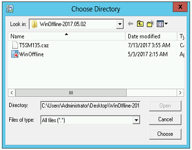

5.    Give a name to the volume and click on the 'Browse' button. Navigate to the temp folder which contains WinOffline.exe and the .caz file(s). Click 'Choose' and OK.

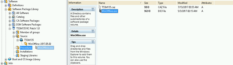

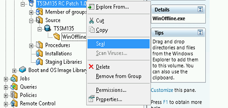

6.   Expand the Source->Package Name->Folder Name. Drag and drop WinOffline.exe from the right pane to the "Procedures" tree item in the left pane.

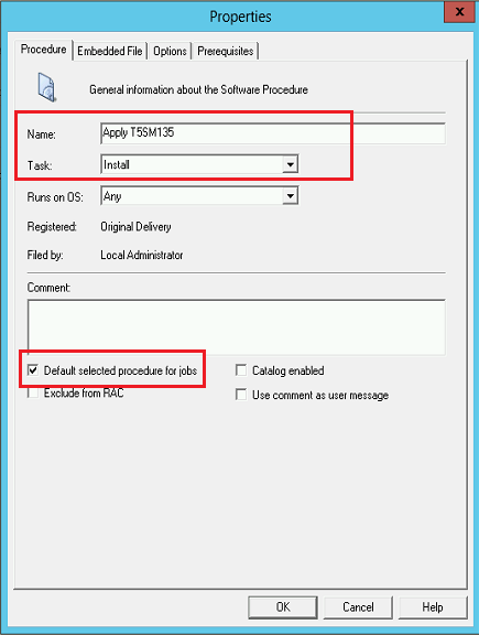

7.   Right-click the procedure and select properties. Give the desired name to the procedure and make sure that the Task is set to 'Install' and the 'Default selected procedures for  jobs' option is checked.
8.   Right-click the package and select "Seal" to seal the package.

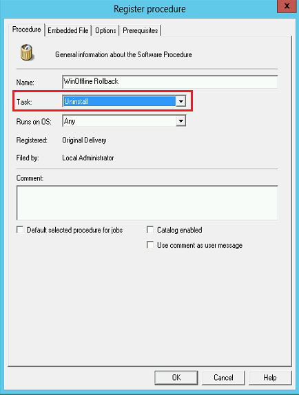

3.    Give the desired name to the Procedure. Change the procedure task to 'Uninstall'.

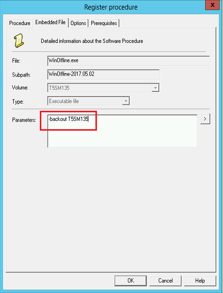

4.    Under the 'Embedded File' tab specify the parameter "-backout <patchname>" parameter and click OK.
      Ex: -backout T5SM135
