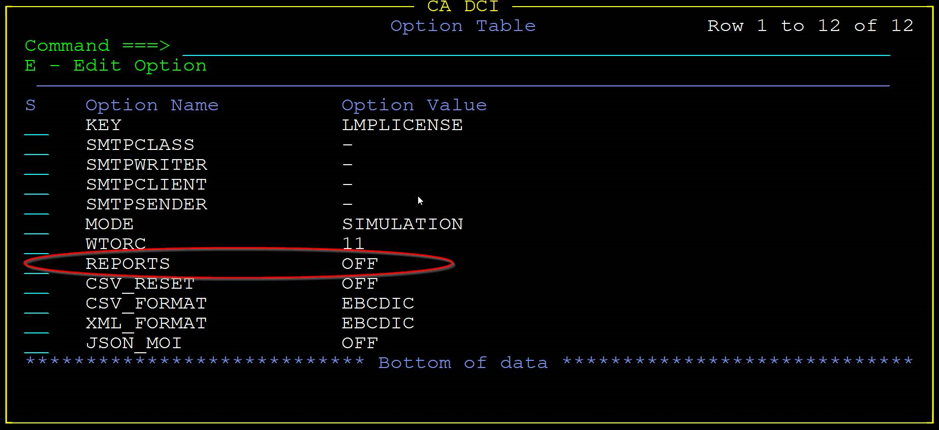

Please note that before running that job, the REPORTS parameter must be set to OFF in ISPF CA DCI Option Table:
and then turned ON again after CSVBATCH job successfully completes.
