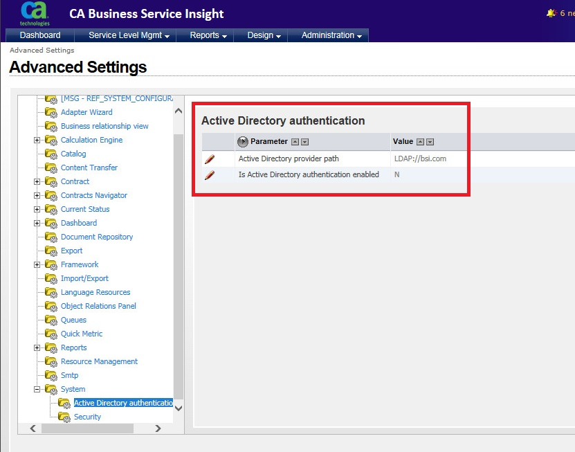

Out of the box, BSI contains a LDAP integration feature which can be enabled in the advanced system settings, as shown below:
This feature is documented in the BSI documentation at Active Directory Single Sign-On
It is important to note what this feature does and does not provide
It does:
  • Provide password authentication for the user against the password stored in LDAP, as long as the user exists in both BSI and LDAP. This means the user passwords no longer need to be maintained in BSI
It does not:
  • Provide SSO where you no longer need to login to BSI. You must still type in the BSI/LDAP username and LDAP password at the BSI login page
  • Does not synchronize the LDAP users. The users who need access to BSI must still be created in BSI and there is no out of box feature to delete them when they are no longer in use or to create them automatically.
