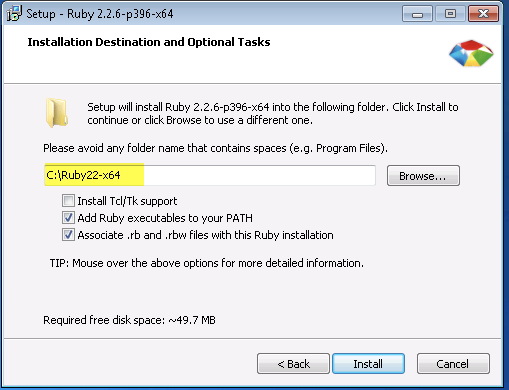

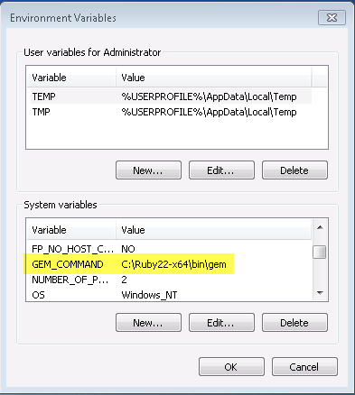

1. Invalid Setting
Update the GEM_COMMAND environment variable to reflect your actual installation directory. This is the directory you would have chosen when you installed Ruby as shown in the image below:
In the error message above, Ruby is installed in C:\Ruby22-x64 so GEM_COMMAND should be set to C:\Ruby22-x64\bin\gem as shown in the image below:

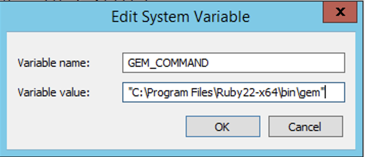

2. Referencing a location that contains a space in the path
If your Ruby interpreter has been installed under a folder that contains a space in the folder name, it will be necessary to include quotes around the full path of the GEM_COMMAND location as shown in the screenshot below:
