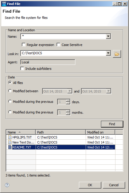

Use the Find File dialog to search for and select the file(s) to be checked in, then click “OK”:
