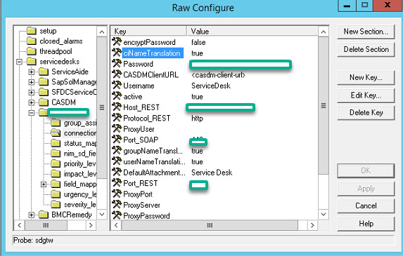

The configuration requires two things: 1- CIs need to be pre-populated in CA SDM: https://communities.ca.com/docs/DOC-231177806-tech-tip-importing-ca-uim-devices-into-ca-service-desk-manager-cmdb 2- The configuration parameter "ciNameTranslation" is required and must be set to true.
After changing in the cloned configuration definition in the sdgtw.cfg and adding under connection details the missing parameter ciNameTranslation true the Ciname gets populated again
