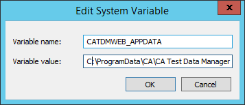

Change or SET the system environment variable CATDMWEB_APPDATA to the path where you want your log files to be written. An example screenshot for doing this through the Windows control panel is shown below:
