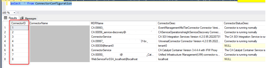

-- First you need to locate your ConnectorID from ConnectorConfiguration table:
select * from ConnectorConfiguration
Below the result from my lab.
Here let's say I'm deleting "ConnectorID = 5"
-- So in the above query you should determine and take note of the connectorI you need to delete. For example "connectorid = 5"

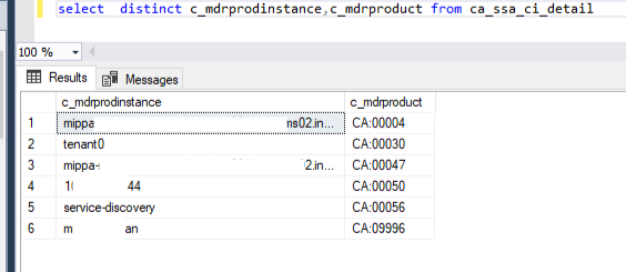

--Then locate your " c_mdrprodinstance" from the ca_ssa_ci_detail table run the query below:
select  distinct c_mdrprodinstance,c_mdrproduct from ca_ssa_ci_detail
--from the above output Take note of the "c_mdrprodinstance" you need to delete

Ont the query below you have to replace the red part, with your previously noted  "c_mdrproduct and" "c_mdrprodinstance
delete from ca_ssa_ci_detail where c_mdrproduct = 'CA:00050' and c_mdrprodinstance = '10xxxxxx.44'
