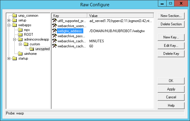

 Configure the adminconsoleapp to use the webgtw
  1. using Raw Configure to configure the adminconsole webapp
        wasp ~~> Raw Configure
  2. Navigate to
        webapps ~~> adminconsoleapp ~~> custom ~~> uncrypted
  3. Set the webgtw_address to the UIM address of the webgtw probe
       ex. /Domain/HubName/HubRobotName/webgtw
    Note: The nimbus address is case sensitive
Next, start the webgtw probe and then restart the admin console's wasp probe
NOTE: Configure the webgtw using the configuration screen from the Admin Console and do not update via Raw_configure.
