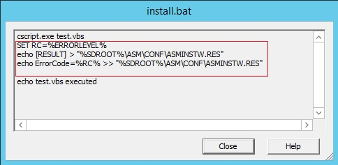

Example :
After adding the 3 lines in install.bat :
SD Job reports the exit code of test.vbs script
This solution could be applied for vbs script but for other kind of script too like .cmd, .bat, .ps etc...
