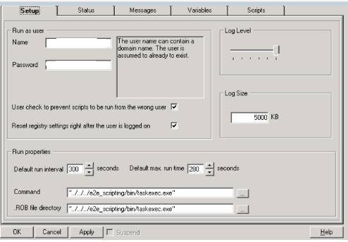

Below is the default e2e probe configuration for the pathing to the taskexec.exe file and the location of the compiled scripts. Note: as mentioned, as per current probe design/defaults, it is relative to the probe installation directory.
   rob_file_dir = "../../../e2e_scripting/scripts"
   command = "../../../e2e_scripting/bin/taskexec.exe"
